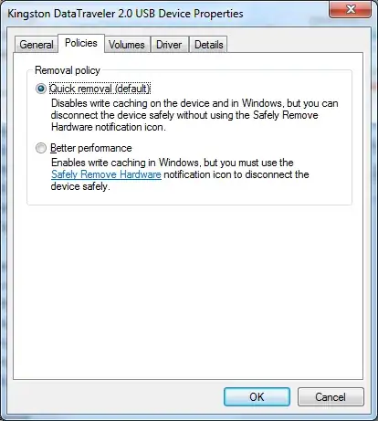

However there is another option (and it is likely already set for 99% of all removable media). If right click on the device and go to properties. Then from there go to the hardware tab and find your device.
Click Properties, then click on the Change Settings button on the new page. Go to the Policies tab.
If you device is set to "Quick Removal" you can remove your device without going though "Safely Remove Hardware" without worrying about data loss.
If you do not have a Policies tab you likely skipped the Change Settings step.

    Most complete answer! Images say more than a thousand words – kokbira Apr 10 '12 at 16:44

It depends what style you set the drive to (optimize for performance or quick removal). Some filesystem updates are not written in performance mode until the drive is manually unmounted (i.e. clicking Safely Remove Hardware). So long as your device is not in performance mode (i.e. in quick removal mode, so write caching is disabled), you can just remove the device.
If it is, you have no choice but to click Safely Remove Hardware. This is the only way (aside from manually doing it through Computer Management) to unmount the filesystem safely. If you don't, nothing will probably happen - but it certainly could, and the filesystem certainly won't be as reliable as a clean mounted/unmounted one.
