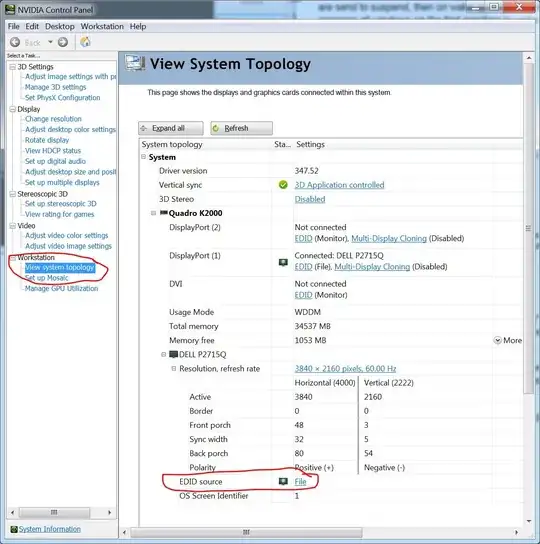

An NVIDIA graphics card may fail to read the EDID info from the monitor when returning from a standby mode. You can fix it by setting your monitor settings from a file with previously saved EDID info.
  1. Start NVIDIA Control Panel (e.g. by typing in that name into the search field).
  2. Open the "View System Topology" task.
  3. Click EDID source. We will change the value from Monitor to File. (the screenshot shows the end situation after step 7) View system topology

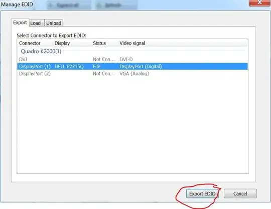

  4. In the manage EDID dialog click the "Export" tab.
  5. Export the monitor settings to a file from the monitor you want to "hard-wire" the settings. This prevents the resizing/moving windows. Export EDID file

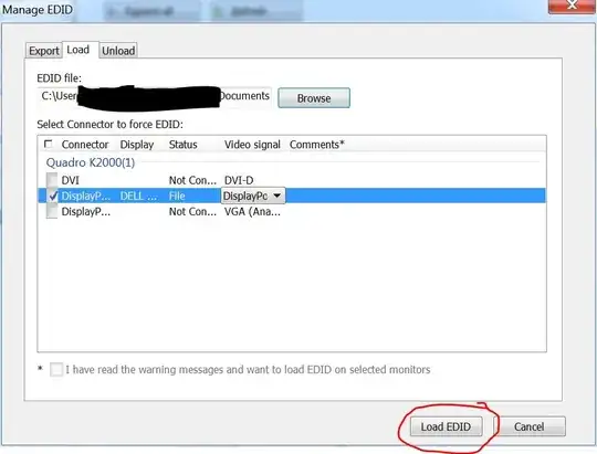

  6. Change to the "load" tab.
  7. Load the just exported monitor file and select the same monitor to apply the fixed settings. Then click the "Load EDID" button. Load EDID file

  • Not a fix, more a workaround. – Little Helper May 04 '15 at 10:31
    Yes, it's a workaround. But that's ways better than nothing at all. – Tobias Weibel May 05 '15 at 10:49
    My NVIDIA control panel doesn't have that "workstation" node on the tree. – johntrepreneur Feb 07 '17 at 17:28
  • Works great for me. – Stabledog Jun 29 '17 at 16:48
  • @LittleHelper a real fix would be to replace the NVIDIA graphics card, but we still do not know if the root problem is with NVIDIA or Windows, or DisplayPort, or the monitor itself. This answer works for me: Win7, Nvidia, Displayport, Lenovo X1 4k monitor. – Roland Feb 22 '18 at 15:18
    The same workaround is also useful on Windows 10 and a 4K monitor connected with a display port cable. Basically it prevents moving windows around when monitor enters (or leaves) energy saving modus. – Tobias Weibel May 03 '18 at 08:44
    I read that only the Quadro cards have the Workstation options – Enchiridion Sep 04 '20 at 06:32
  • Had to do this at one point, and had to do it again when I reimaged the PC. I guess the driver version picked up automatically by Windows (7) was too old. Installing this driver version made the "Workstation" node show up again: https://www.nvidia.com/Download/driverResults.aspx/110262/en-us/ – InterLinked Aug 25 '23 at 11:01
