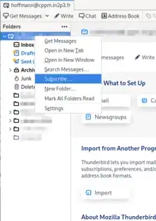

It seems that the mechanisms and tricks of folder synchronisation has changed a lot since the OP. I could not follow the instructions given in many of the other answers. The following worked for me in 2022 (v91.7.0). Actually it is quite similar to the post of 10 years ago.
Screenshot of Thunderbird dialog with folder::subscribe item selected in drop-down menu
  • Right-click on folder line (the one above the Inbox folder). Clicking on other lines will not give access to the next step.
  • Select "Subscribe" item from the drop-down menu. A dialogue pops up.
  • Check boxes for the folders that you want to see, uncheck those you don't want. The dialogue allows multiple selections/actions at once.
  • Close the dialogue.
The list should be updated now. If newly added folders are big, it may take some time to synchronise their contents though.
