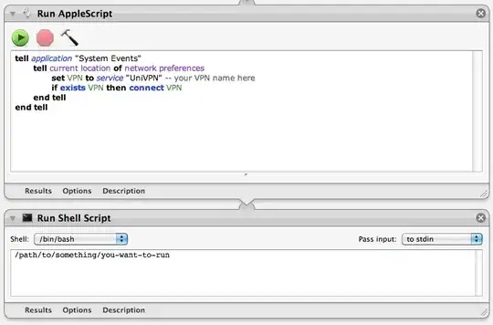

If you want a GUI way to do it, open up Automator.app and create a new Application. Then, drag the actions to run an AppleScript and Shell script from the left pane, and insert the commands as shown below.
You can then just put this pseudo-application into your Dock to quickly launch it.
