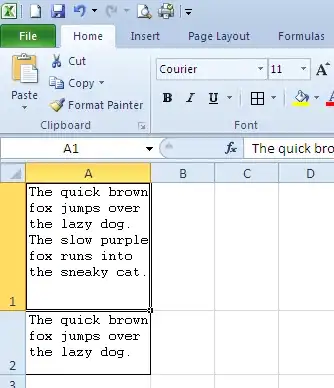

Simple test case:
Why is there a one-line gap after the text in cell A1 but not in A2?
(To reproduce: set width of column A to 17.14 (125 pixels), text wrap on, and cell alignment top.)
(I double-checked that I applied Auto Fit Row Height to both rows. Zoom level is 100%.)
Auto Fit fails for the first row, succeeds for the second
Is there any known remedy for this without resorting to manually adjusting the row heights (which is not practical for more than a handful of rows)?

  • In case anyone wants to reproduce the example in my question, the width of column A is 17.15 (125 pixels). – devuxer Feb 14 '12 at 21:47
  • Can reproduce this – Raystafarian Feb 14 '12 at 23:54
    Bug seems dependent on font and font size – Raystafarian Feb 15 '12 at 00:08
  • Raystafarian, also zoom. – devuxer Feb 15 '12 at 00:09
  • The workaround would be to auto-fit column instead. – Raystafarian Feb 15 '12 at 17:01
    @Raystafarian, doesn't seem to work with Wrap Text turned on. – devuxer Feb 15 '12 at 17:29
    I tried autofitting the columns, which widened one column, and then autofitting the rows. That got it down from 73 to 64 pages but still lots of blank lines at the bottom of most of the rows. I have the rows aligned top. Manually changing the size of the rows makes it look OK when I'm working on the doc, but not in the preview or in print. –  Aug 05 '12 at 07:15

Excel's WYSIWYG isn't the best. In your picture, 'cat.' just barely sneaks into the 5th line. If you reduce the zoom percentage to anything less than 100% (99% for example.) then 'cat.' is now wrapped down to the 6th line. I think Excel is trying to auto-fit in a way that will ensure everything is almost always visible no matter your zoom level.
That isn't the only problem you will have with AutoFit. In addition, the way a word-wrapped cell is printed won't always match what you see on screen. Take your example and change the font to Courier while leaving size at 11.
Changed font to Courier
As you can see, cell A1 appears to be given 1.5 extra lines. Now look at print preview, 'cat.' is completely hidden.
print preview of same file
In my experience, Excel has this problem with certain fonts and font sizes more than others. Courier is worse than Courier New, size 11 is generally worse than 10 or 12. (Why they picked size 11 as the new default, I have no idea.)
