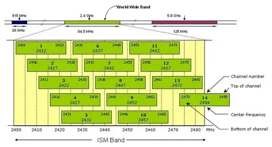

Wifi channels 1, 6 and 11 do not overlap.
However, any channel in between them does.
https://i.stack.imgur.com/GVjVb.jpg
e.g. channel 3 would use some of the frequency band of channel 1 & 6, and channel 9 would use some of the frequency band of channel 6 & 11.
Why would one choose to use channel's other than 1, 6 or 11 if that is the case.

Cisco has a deployment page that illustrates this. The problem comes from having the center frequencies on 5kHz separation, but with 22MHz wide passbands. Normally, in a radio frequency assignment plan, you have for example a 12.5kHz passband and channels on center frequencies every 12.5kHz. Adjacent channel interference usually means you assign out every other channel in a local area, unless the spectrum starts getting crowded.
Because of the insane amount of overlap on 802.11, in a close area, say a warehouse, you can only use 1, 6, 11 without adjacent channel interference. Down the street where the signal falls off, someone else could use channels 2 & 7 simultaneously, a little further on, 3 and 8, and so forth.
As to the reason for the overlap, I'm guessing that they had too much faith in their spread-spectrum modulation scheme they were using when the specs were created.

IEEE 802.11 signals are designed to partially overlap!
So, go ahead and use those other channels!
First of all, it is important to note that the cited Cisco paper only applies to a single organisation controlling all of the IEEE 802.11 signals inside one building. It does not apply to the myriad of WiFi signals you may encounter when scanning your neighbourhood. "WiFi in the wild" so to speak, is a different story.
A lot of people mistakenly consider IEEE 802.11 signals like solid cars on a multi-lane highway. They frown upon people driving over the lines, partially occupying more than one lane.
However, Wifi signals are rather like coloured plumes of smoke. Along the open lanes, the colour plumes are allowed to intermingle. As long as I can still tell the colour of my plume of smoke at the end of the road, all is fine. The partial overlap of differently coloured plumes is then like a grey mist of noise to my signal. This technique, employed by 802.11b, is called spread spectrum, or rather direct-sequence spread spectrum (DSSS) to be precise. The technical term for "plume of smoke" in DSSS is pseudo noise (PN) code. 802.11g circumvents in-channel noise through orthogonal frequency-division multiplexing (OFDM) of a multitude of narrow (hence slow but more reliable) carriers.
For this very same reason, in moderately congested neighbourhoods, one stands a very good chance to benefit from not sticking to the proposed 1-6-11 channel scheme. Not sticking to 1-6-11 will prevent your devices from being silenced by the IEEE 802.11 RTS/CTS/ACK (Request to Send / Clear to Send / Acknowledge) of alien devices on the same channel. So not sticking to the 1-6-11 channel scheme may effectively increase your data throughput in many cases. You will need to test it on a busy time of the day to know for sure.
Also consider the band edges which may offer protection of overlap at one side of the spread spectrum channel. Over here in Belgium, I am lucky that I may use channel 13 centred at 2.472 GHz. In some geographies you may even use channel 14 centred at 2.484 GHz which has no overlap with any of the 1-6-11 channels at all! Most equipment though comes preconfigured for use in the US where the available 2.4GHz channels are limited up to channel 12.

It is because other people use those channels, and as such, having a overlapping but less crowded channel is better than having the same channel as someone else. It would have some contention, but not as much

You really shouldn't use the "other" Wi-Fi channels, but here are some reasons for why they may be used, as well as some general information about 802.11 channels and interference.
When I talk about reliability, I'm referring to a wireless link that delivers a constant minimum speed, which is very important for things like VoIP and video conferencing. Speed refers to the average throughput which is important for downloads.
In the US, you can use channels 1 to 11 (or 1 to 9), giving you 3 non overlapping 22MHz (or 20MHz) channels, and in Europe channels 1 to 13 can be used, providing 4 non overlapping 20MHz channels, or two non interfering 40MHz N mode channels. Each channel is 5MHz wide and Wi-Fi needs 20MHz of separation. 11b DSSS/CCK Wi-Fi actually uses 22MHz, leading to the more ideal 25MHz recommended spacing of channels 1, 6, and 11. That's mostly obsolete, but even g networks fall back to DSSS at their lowest bitrates, so 25MHz still can help a little.
The 5GHz band has 9 non overlapping 20MHz channels (notice how they skip by 4), with the some of the newer equipment adding 4 or more channels.
Reason 1: All of your Wi-Fi client devices remain very close to your access point at all times, and you don't care about causing interference to others or having a reliable connection farther away. For example, you have neighbors with networks on channels 1, 6, and 11, but when doing a speed test while being very close to your access point, you found that using an in between channel such as channel 3 was the fastest. The reason is your wireless devices avoid generating interference by not transmitting when they can detect other Wi-Fi traffic being transmitted on the same channel. By using channel 3, this feature is effectively disabled and your devices can no longer see traffic from your neighbors' networks. Your devices then operate at full speed because no interference is detected. As long as your devices remain very close to your access point, the interference from your neighbors on channels 1 and 6 won't be strong enough to cause interference to you. But now the users on channels 1, 3 or 6 will have horrible reliability if they move farther away if two of the overlapping channels are in use at the same time.
Reason 2: You're using 11b DSSS modes that are more tolerant to overlapping. Because these are spread spectrum, a channel that overlaps somewhat just degrades the quality of the link resulting in a lower possible bit rate or range. You may be able to squeeze 4 channels in to the channel 1 to 11 range and obtain higher performance. 11b is long obsolete and there is really no reason to do this when you can have 3 non interfering 54mbps OFDM channels (or 4 in Europe). Have you ever seen your Wi-Fi card transmit at 2, 5.5, or 11mbps DSSS (11b) modes when 6mbps OFDM (11g) should provide better range than 2mbps DSSS? This may be because DSSS is more tolerant to a partially overlapping channel than OFDM is.
Reason 3: You're still using some very old wireless equipment that predates the 11b standard, or you're using a special narrow band 5MHz wireless channel, or you're trying to avoid interference from a narrow band device like a baby monitor or microwave oven. In this case you might use channels 1, 5, and 9 leaving the top end of the band (above channel 11) open for the other equipment.
