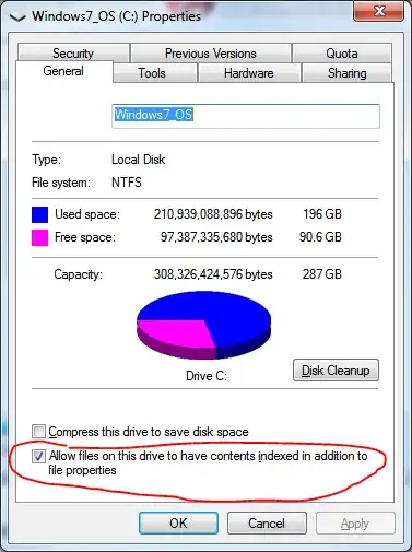

To have Windows not randomly access the drive, all you should need to do is make sure that indexing for the drive is disabled. This, combined with the power management settings, should keep the disk quiet until you manually access it.
I used this method to keep my external drive that I use for backups quiet at all times, unless it's actually backing up data.
To make sure indexing is disabled, you just go into your Indexing Options window by clicking the start menu orb and typing "Indexing Options" and hitting Enter. A window that should look like this should pop up:
Then just find the entry corresponding to the drive you want to keep quiet and remove it from the list by clicking the Modify button and then unchecking the drive in the list that comes up.
As an added safeguard to make sure it won't index it in the future, go into My Computer and right click the drive and then choose Properties. On the bottom, you should see an option with a checkbox called "Allow files on this drive to have contents indexed in addition to file properties":
Uncheck that option and click OK. Your drive should stay quiet until you actually call upon it, and you won't need to unmount/remount it manually.
