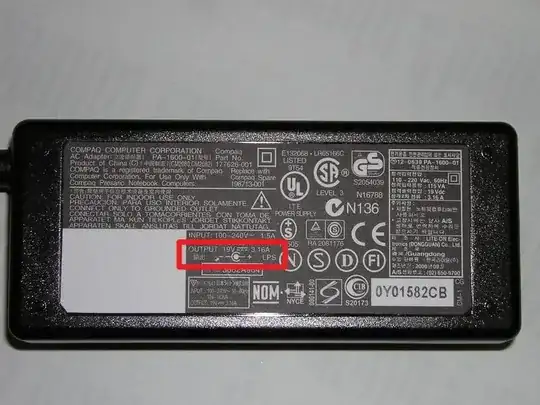

Turn it over and look for the voltage and amp rating. If these are the same, then it is 100% safe and guaranteed to work. You can use alternates when it is different, but it is not always safe just because it fits.
You want to look for something like this on both devices:
alt text
Input to the power adapter is not to important, you want to match up the output of the adapter to the input of your laptop.

  • Thanks. The Sony power supply says 16 volts, 4 amps; the dell one only says 65 watts. 16 * 4 = 64, so that sounds right, but I assume the volts and amps should match up properly... – Colen Sep 05 '09 at 18:07
    @Colen - there are many ways to make 65 from volt * ampere. If you get it wrong at best you'll end up with a dead power supply, at worst you'll end up with a dead laptop. – ChrisF Sep 05 '09 at 19:11
    You also want to match the + and - making sure the correct one is in the center on the power supply. – Joshua Nurczyk Sep 19 '09 at 19:23
Current Dell adapters are 19.5 volts (including all of the Vostro lines that I've run into.) So do not plug in that Sony adapter.

The Voltage, Amperage, Notebook Plug and Polarity have to be the same.
