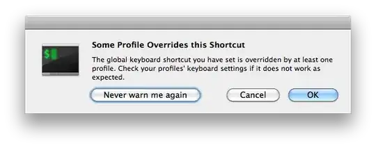

On OS X control+left and control+right normally control spaces. I have disabled those. I also tried to use the preferences pane to set the keyboard shortcuts:
However this does not work and causes this error:
Also, if I am in iTerm and use alt+escape then B or F the character moves back and forth. This was happening before any of my config changes. But I'd really like to be able to use control + the arrow keys.

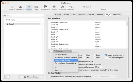

110
Working solution for zsh. Simple, straightforward, out-of-the-box.
  1. Goto: ⌘, Preferences → Profiles → Keys → Keyboard Behavior
  2. Load Preset: Natural Text Editing
Load Preset "Natural Text Editing"
    Thanks @Happy Torturer, I believe it's best answer mostly because I don't have on plain Terminal.app that problem so I don't want to modify bash/zsh, just want to work everything like in Terminal.app. – galuszkak Sep 23 '17 at 17:07
    This, this, this. Thank you so much for this solution! I've gone through this maddening process with each Mac I get. I now know the simplest way to make this happen. Thank you! – vernonk Nov 22 '17 at 04:55
  • This should be the accepted answer. I wonder, is there any way to load this preset from the command line rather than going through the settings GUI? – Janosh Dec 16 '19 at 09:20
  • This should've improved the @rassom answer rather than providing a same answer with screenshot. – Player1 Jun 01 '21 at 15:40
    Worked for me, but I needed to also disable misson control shortcuts that were having higher priority, once disabled that "Naturel Text Editing" worked – Guillaume Petit Nov 27 '21 at 21:14
  • I appear to be missing this preset :/ – Shayne Dec 02 '22 at 01:58
  • This should be the correct answer. – Jay Aug 08 '23 at 03:53
21
I fixed it this way:
In top menu; go to
Profiles
-> Open profiles...
-> Edit profiles... (button)
-> Keys (tab)
-> Load Preset... (dropdown)
->  Choose "Natural text editing". Done! :-)

Actually, I found the easiest solution was to go to my profile settings (found in Profiles/Keys), removing the offending profile shortcuts(as profile overrides global in iTerm), in my case alt+left and alt+right and then the global shortcuts worked perfectly for me!
Also, if you're using OS X, it's probably best to stick with system wide shortcuts, i.e. using alt+left and alt+right instead for this purpose, having different behaviour in terminal is bound to cause a pain eventually.
Other than that chmac's solution to use Better Touch Tool was an elegant way to change control+arrow's behaviour in iterm only.

In the newer versions of iTerm (as of writing 3.4.19):
Navigate to PreferencesProfilesKeysKey Mappings.
From Presets dropdown, select Natural Text Editing.
Saikat
