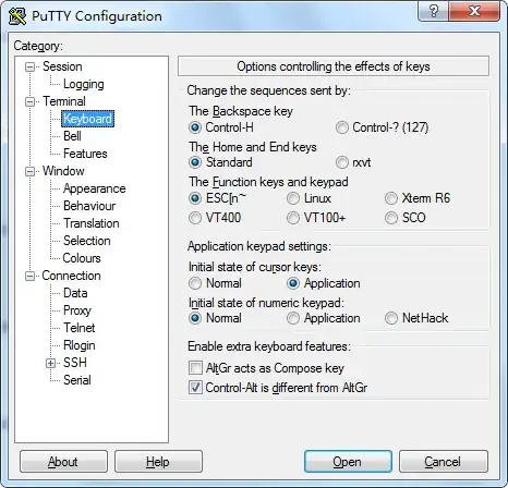

I'm using putty on win7 as client, to log into ssh on a debian server. But I've met a strange problem about keyboard behaviors on putty console.
I noticed that it's about keyboard config in putty. After reading the manual of putty, I successfully made backspace key to work, but still have troubles about ESC, arrows, home and end, and F1-F12 keys.
Here is my keyboard config in putty
Here I list their behaviors below. It seems that the mismapping of ESC is the root cause.
  • ESC => ^[
  • up => ^[OA
  • down => ^[OB
  • right => ^[OC
  • left => ^[OD
  • home => ^[[1~
  • end => ^[[4~
  • F1 => ^[[11~
  • F12 => ^[[24~

The problem is the value of the TERM environment variable does not match the configured terminal characteristics - specifically the "Home and End keys" and "Function keys and keypad" settings.

What is actually sent by Putty.
To see what Home actually sends, run vi, press i (for insert mode) press Ctrl+V then press Home and press Esc to exit insert mode.
Solution
Adjust Putty config (or TERM) until what is sent matches what the other end expected.
E.g.
Do as specified in https://www.chiark.greenend.org.uk/~sgtatham/putty/wishlist/terminfo.html then in Putty, Configuration, Connection, Data, terminal-type string = PuTTY and save that. Maybe.
  • Making sense, but the problem is I can't even get ESC to work, let alone home. Seems like I have to solve ESC first, right? – OpenGG Oct 04 '11 at 14:59
  • If the ESC key produces ^[ as output, it works as designed. – ktf Oct 04 '11 at 15:03
  • @Rufus: ktf is right. Your problem is not the Esc key since the other key definitions in no way depend on how the Esc key is defined. ^[ is short for Ctrl+[, Just as ^A is short for Ctrl+A. [ is the 27th "letter" and Esc is the 27th control code (see ASCII table) – RedGrittyBrick Oct 04 '11 at 15:23
  • For things as standard as Debian and PuTTy, isn't there an off-the-shelf recipe like "upload this config to Debian and this to PuTTy and have the best possible experience ever"? – hypersw Feb 05 '18 at 18:25
  • @hypersw https://www.chiark.greenend.org.uk/~sgtatham/putty/wishlist/terminfo.html then in Putty, Configuration, Connection, Data, terminal-type string = PuTTY and save that. Maybe. – RedGrittyBrick Feb 05 '18 at 18:39
There is no mismapping of the ESC key - ^[ means Control-LeftSquareBracket which is ASCII 27 which is ESC
