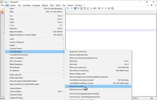

Edit: Newer versions of Notepad++ (v8.0+) now directly support reversing line order. Simply go to:
Edit -> Line Operations -> Reverse Line Order
Note that it will reverse the order of selected lines, or reverse all lines in the file if nothing is selected.
Since the menu is quite full, here is a visual hint:
position of the command in the elaborate menu structure
For older versions of Notepad++, the previous strategy can still be used.

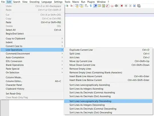

This can also be done in Notepad++ without the TextFX plugin. It follows the same strategy of that of the accepted answer, but using native functionality. It is done as follows:
  1. Edit > Select All
  2. Edit > Column Editor... > Select Number to Insert > Set Initial number to 1 > Set Increase by to 1 > Check Leading zeros > Click OK
  1. Edit > Line Operations > Sort Lines in Descending Order Edit: A recent update added extra sorting options, the option: Sort Lines Lexicographically Descending seems to do the job.
  1. Remove Line Numbers through either box selection (Alt+Left Click Drag or Alt+Shift Select) or Search/Replace
