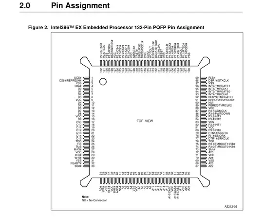

Chips usually don't turn off and then turn on. Instead, there's a reset line which will bring processor in so-called reset state when usually all memory is cleared and processor looks like it's just been powered on. While that pin is held high (or low, depending on the processor), the processor is in reset. Once the pin is released, it will continue booting normally, just as if it was turned on for the first time. The point of this is that there's no power cut itself.
So how does this scale to larger systems like modern PCs? Well modern computers are made out of computers which are sometimes made out of computers themselves. So when you set computer to reset, "computers" which make the computer will start saving their states (if the reset is controlled), or just have their reset pins pulled.
Some processors and microcontrollers (which are miniature self-contained computers, usually 20 years behind the modern desktop computers) can reset themselves using internal switches. As I said, once the signal which generates reset is gone, the computer will start up. So the premise in the question isn't completely right. Computer doesn't know when to turn on. In know when it needs to be "off" or in reset and when the signal which keeps it there is gone, it will turn on.
This behavior may look strange on modern computer which can be set to turn on at specific time or over network and so on. As I said computers are made of computers. So while the main processor may be off, there could be numerous other chips and microcontrollers inside which are on. The most obvious case is the real-time clock which is often battery powered. It can then turn on other chips which will turn on other chips and the chain reaction goes until the whole computer is on. On today's computers, there's a PSU line called +5 VDC Standby Voltage. It provides around 50 mW power to various devices that are on when computer is "off".
A little bit of trivia: Reset pin on Intel 386 EX processor is pin number 110.
386EX datasheet figure 2
On Intel i7-900 it's land number AL39.
