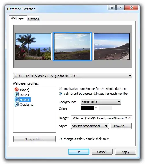

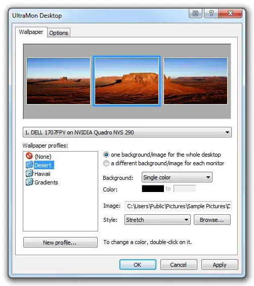

UltraMon from Realtime Soft supports this.
By default, you are limited to using the same background image on each monitor. With UltraMon, you can use a single image for the whole desktop, or different images for each monitor. In addition, you can also create gradient color backgrounds.
Wallpaper using a different image on each monitor:
alt text
Wallpaper using a single image stretched across the desktop:
alt text

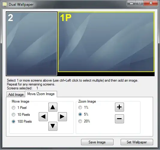

MurGeeMon can be used to have two wallpapers for 2 monitors. To know more have a look at the dual monitor software http://www.murgee.com/MurGeeMon/

Because the dual wallpaper solution requires a stitched image, I will add another method to easily stitch two images together.
Irfanview is a free, lightweight image viewer which also allows you to stitch images together using the "Image > Create Panorama Image" feature. Keep in mind this is for images (and monitors) of the same resolution.*
If your monitors are physically and logically arranged the same, then the left image will appear on the left monitor and so forth. If they are physically arranged differently (for example, monitor 2 is to the left of monitor 1), you will need to swap the images such that they appear in reverse order in the panorama image. They will appear in the proper order once selected as tiled wallpaper.
*Note: If your monitors are of differing resolutions, then you will need to add space to the image as necessary. For example if the monitor on the right is of a lesser resolution, you will need to add space above or below the image so that it equals the height of the left image.
It can get complicated if your secondary monitor is physically located to the left of your primary monitor, the monitors are differing resolutions, and you have the alignment of the two monitors adjusted in a such a way that the tops of the monitors do not align. In such cases, the image will wrap on the larger monitor at the height of the 0,0 coordinate of the smaller resolution monitor.

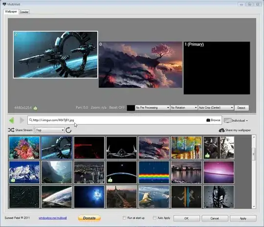

MultiWall was the only lightweight and extremely easy-to-use and bug-free piece that worked as needed, in my case. And has an image web crawler on top of it.
