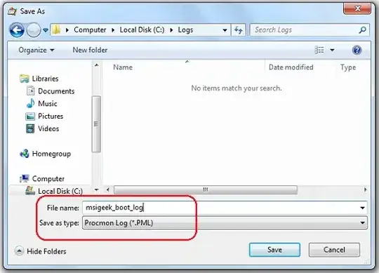

. Step 5: The file will initially be saved as a dump file in C:\Windows, you will need to convert it to Process Monitor Log (pml) log files. Save the Log file using this below dialog. This will start converting the dump file to pml file.
. enter image description here enter image description here
. Once the Log is converted, it will open in the Process Monitor tool.
