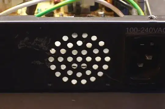

I would find a drill and put a series of holes in the cabinet to allow airflow. Specifically, place holes near where the power supply exhaust fan will be located and near where the bottom front of the case (cool air intake) will be located. A few holes on top (if possible) would be nice as well. And if you really want to do this right, find a way to mount a fan over one set. What you're going for is something like this:
Ventilation holes
