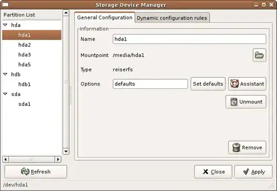

Using the image below as an example, you'll need to look through the partition list until you find the partitions that relate to your Windows install (by checking the mount points). Where you see the options field below, you'll probably have something like user,noexec. You'll want to keep whatever options are already there, but add ro (for readonly) to the list of options (for example: user,ro,noexec).
After a reboot you should hopefully be able to read but not write to your NTFS partitions, and therefore they also should be protected against corruption. As mentioned earlier, a USB memory stick or a partition formatted to FAT32 should be safe for files needed by both systems. Dropbox is also a possibility for keeping files in sync between the systems.

  • Yes, worked like a charm. I am unable to mount the system partition and writing to the data partition is disabled. Have restarted a couple of times to check - no corruption yet :) – kostja Mar 22 '11 at 16:54
