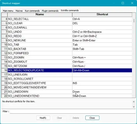

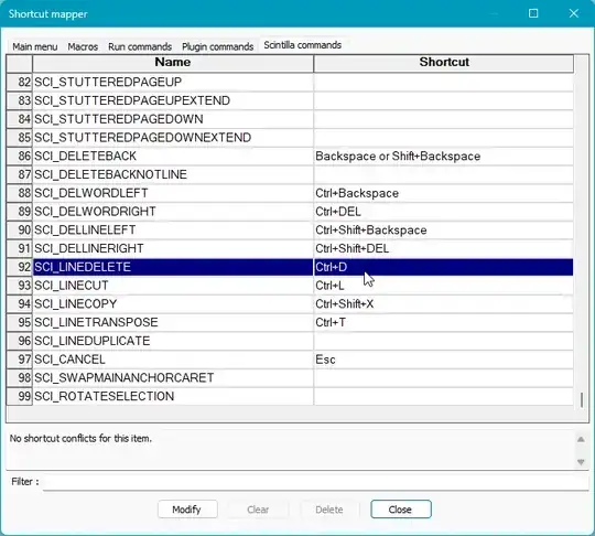

What you can do to make Notepad++ behave more like Eclipse is to:
  1. Map SCI_SELECTIONDUPLICATE to Ctrl+Alt+Down (or Ctrl+Alt+Up)
  1. Map SCI_LINEDELETE to Ctrl+Alt+Down (or Ctrl+Alt+Up):
There is BTW a file called shortcuts.xml in the root of the installation folder where these changes can be found. I wouldn't rely on copying this file around however, since I've had problems with that approach installing the same shortcuts on more than one computer.
