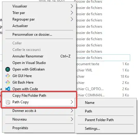

I had exactly the same problem -- not everyone had the same mapped drives as me, or mapped to the same letters.
After much searching I found a context menu extension named Path Copy Copy on GitHub (https://pathcopycopy.github.io/) which is an extended version of a similar, older extension (called Pathcopy) has quite a few options for copying paths as text, including one for UNC paths -- example of the options available are shown below:
Path Copy Context Menu example
You can also choose to show only one or two lines on the base context menu, for example you can have two lines, Copy Long Path, and Copy Long UNC Path. It's great for emailing users in your company who have access to a network path, and if they have the same network mapping as you, you can choose the former, otherwise you can use the latter.
Update: As of version 12.0, a new "portable" installer is available on the above site, which installs only for the current user into the AppData\Local folder. I've not tried this, but it could be solution for those who are prohibited from installing normally.

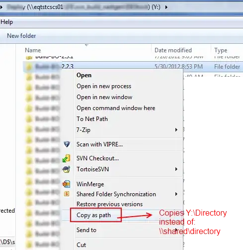

Here's the workaround I use when sending mapped-network paths via Outlook:
  1. In Windows Explorer, hold the shift button down, r-click on the file, and select "Copy as path".
  2. Insert a Hyperlink in the email and paste in the address field of the Hyperlink dialogue box. (Shortcut: ctrl-K ctrl-V + OK). At this point, the link will display the mapped drive letter as the root (Q:\foo.doc).
  3. Now, r-click and select "Edit Hyperlink..." you will notice that the Address field has been translated back into the full UNC path (\\cartman\users\emueller\foo.doc). With your mouse in the Address field, hit ctrl-A and ctrl-C to copy the full path to your clipboard, then move your cursor to the top field ("Text to Display:") hit ctrl-A and ctrl-V to display it correctly in your email.

Hold Shift down and right-click on the file and select "Copy as path". Insert a Hyperlink in the email and paste in the address field of the Hyperlink dialogue box.
After you create the hyperlink in the email, you're done.
The link will show the mapped drive letter this is true. When the recipient(s) clicks on the link in the email, it will follow the UNC path whether the user is mapped or not.
I have tried this in other Office 2010 applications, Excel, Power Point, and Word.

  • To find the send to folder, type this into file explorer location bar: shell:sendto The script worked fine for me. source: https://www.dummies.com/computers/operating-systems/windows-7/how-to-add-locations-to-the-windows-7-send-to-menu/ – David Lotts Feb 26 '19 at 17:06
Right-click the folder > Share > " share to yourself (means nothing) . you will get the path. / or \ . or click show all network shared.

The SHIFT + RightClick "Copy as path" will copy the drive+filename (i.e. R:\test.doc), or if you are looking at the file via UNCpath the UNCpath+filename (i.e. "\nas\Documents\test.doc")
This is 'standard' behaviour of Windows, and therefore my favorite, above all explorer plugins which slow down systems.... ;)
