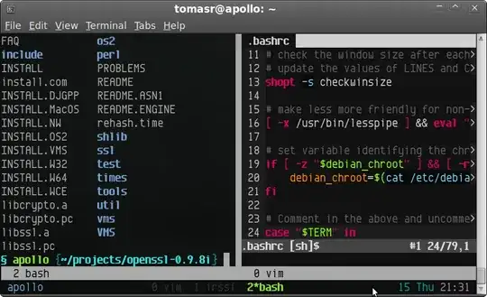

I'm trying to improve the aspect of GNU Screen using the screenrc file, I tuned colors, status line, caption and the list of the loaded windows.
The only thing I'm not able to achieve is getting the caption with the current executed command as in the below picture, note the vim caption in the right pane:
What I currently have is this, and what I would like to obtain is having captions (and if possible also hardstatus line) with |0 less| 1 man instead of the current |0 bash| 1 bash.
How can I do this?
