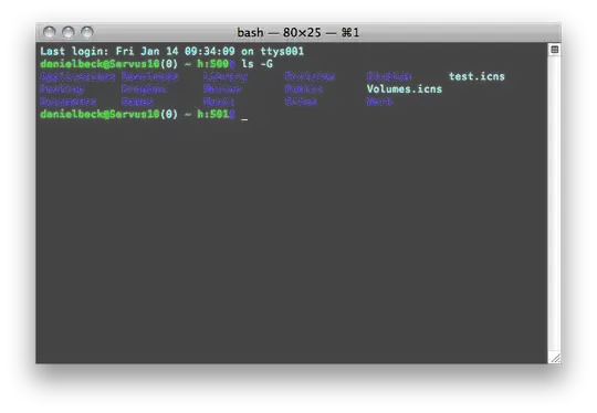

Use the -G switch to ls on Mac:
ls -G
If you'd like the standard ls to always be colored, add this to your ~/.bash_profile:
alias ls='ls -G'

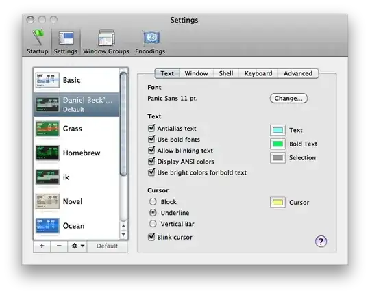

You can change your shell colors in Terminal's preferences.
With these settings, you get these colors (not usually using colored ls, so I don't care):
I don't understand what the issue is here. Colored command output is active by default. The only thing you can/need to do yourself is give normal and bold text different default colors, and actually use the colored variants (e.g. ls -G) of your commands.

@tekknolagi This option enables colored output e.g. of
ls -G. Toggle it with a Terminal window open to see the effect. You can also select different default colors for regular and bold text. – Daniel Beck Jan 14 '11 at 08:32
