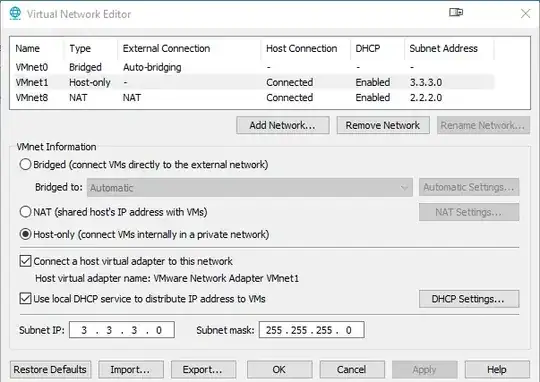

I installed IIS on virtual machine C1,H1,B1,N1 and Windows 10 on C2,H2,B2,N2. These 6 VM are on my host computer. I have another laptop connected by ethernet cable connected to same router as my host computer. I arranged them in pair of each switch type. I have tried this combination with port forwarding on my home router and on virtual machine N1 using NAT switch. This is what I concluded after trying to access the website on each of the device in network. I also configured my Virtual Network Editor settings to create two subnets 3.3.3.0 for VMnet1 (Host only switch) and 2.2.2.0 for VMnet8 (NAT switch). The settings are as below
Since NAT switch has Virtual Router (2.2.2.2) that also act as (Router + Default gateway + DNS server) for 2.2.2.0 subnet so N1,N2 can access Internet on it. But Host Only switch has no virtual router and default gateway so cannot access internet on H1,H2.
Just to summarize which all device can communicate with each other I have created one diagram for understanding enter image description here
