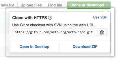

use SSH
To prevent GitHub asking for the password while pushing, ideally you should use SSH (git@github.com:...) instead of HTTPS URL (https://github.com/...) and add your SSH key to your GitHub account. See: Which remote URL should I use?
GitHub - Clone with SSH
