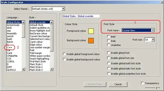

Have you tried setting the global font? Go to Settings > Style Configurator... and then you can set the global font (1).
If you want you can change the font for a particular file format (2).
If you decide to change the global font, you will also need to check the "Enable global font" and "Enable global font size". Both of these check boxes are below the global font (1) question.
Yes, it has the same setting as in your picture. Can't find the Console's configuration in the Style Configurator. As for the file format associated style - thanks, but that is not really what I am wondering about : I want to set the style of the Console window, you know the place where stuff like NppExec outputs get written to. – Per Oct 23 '10 at 19:55
@Per - I thought the global styles would cover the console output. If not I don't know what would. I included the note about file formats for completeness. – ChrisF Oct 23 '10 at 20:13

3Don't forget to check the box "Enable global font." – kmote Jul 27 '15 at 13:31
