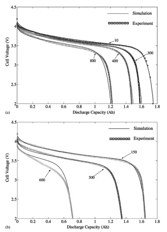

It turns out that the two methods I originally posited are largely moot. The only thing that really matters is temperature.
"Temperature was the most significant factor contributing to the cell degradation, with state-of-charge (SOC) and discharge pulse length of secondary importance." (Liaw et al.)
Furthermore, it turns out that the decay can be accurately mathematically modeled:
Q = A exp(−Ea/RT) * t^z (See Ramadass et al. for explanation of terms)
However, the dominant model is that of the Arrhenius forumla, which generically predicts time-to-failure as a function of temperature.
The figure below shows the capacity at various cycle counts. Just look at the capacity on the x-axis. The top graph is at 25 C, the bottom at 50 C.
After 600 cycles, the cooler battery had ~2x the capacity
P. Ramadass et al. / Journal of Power Sources 123 (2003) 230-240
graphs of discharge
Fig. 7. Simulated discharge curves based on semi-empircal model for temperatures (a) 25 C and (b) 50 C. The dotted curves represent the experimental data obtained for Sony 18650 cells for the respective cycle numbers.
