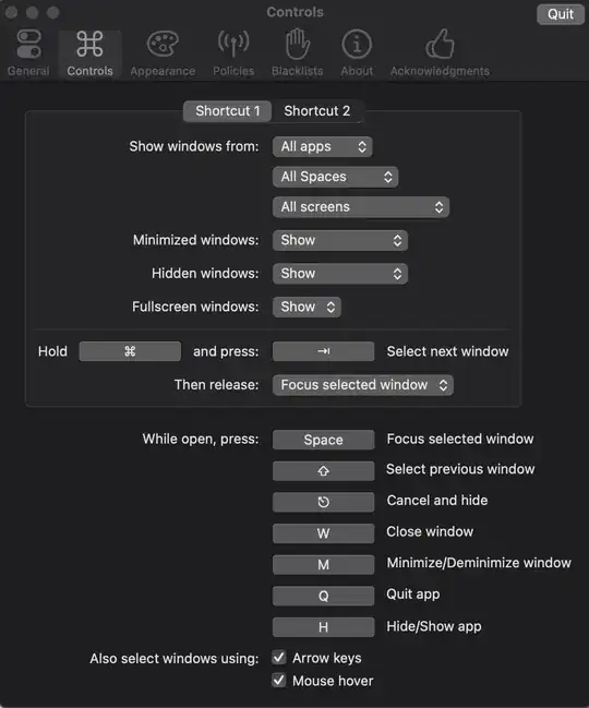

56
Alt-Tab
Alt-Tab is a free solution that has been in my toolkit for a few years now.
The project page includes a comparison between the popular projects.
Download it from the homepage or alternatively from homebrew:
brew install --cask alt-tab
It's free software! Also it has a good amount of customisability and allows to recreate your favourite experience. The settings page should give you an idea about the range of possible options:
Preferences

    Switched to Alt-Tab after hyperswitch started behaving odd - never been happier !! – Neeraj Sep 23 '20 at 16:39
  • homebrew has gone the lazy route and prevents this from working on El Capitan, despite the software itself retaining compatibility. If someone knows how to use brew to install this on El Capitan, I'll be highly appreciative. – Otheus Nov 10 '20 at 21:20
  • Thank you! This is exactly the right answer. – Théophile Aug 27 '21 at 02:35
  • This app does exactly what I was looking for! Ex-Windows users, good news! this app will save you! – Riccardo Nov 24 '21 at 22:41
    This is great, thanks @kos! Also, consider putting that brew command above your screenshot in your answer! I love that you say it's free, Free, and has the comparison. I loved reading the comparison. – may Dec 09 '21 at 22:07
  • Has anyone else had trouble with previews for the Preview app (the default pdf viewer on MacOS)? – John D Mar 23 '22 at 23:47
  • the problem with alt-tab is that it shows either all the apps or only the active windows (usually one) forgetting all the other open windows ... – jjrr Jul 11 '22 at 10:22
  • This app is continuously updating and on every update it is broking some things. Bcs of that this isn't stable. – kodmanyagha Sep 22 '22 at 21:00
  • @kodmanyagha You can find the previous versions in the releases section in Github. Also I encourage you to help by reporting new issues or adding additional information to existing open issues. – Kos Sep 27 '22 at 08:02
  • @Kos https://github.com/lwouis/alt-tab-macos/issues/533 https://github.com/lwouis/alt-tab-macos/issues/510 https://github.com/lwouis/alt-tab-macos/issues/643 All of these issues are mine. There are lots of unresolved issues too. – kodmanyagha Sep 27 '22 at 11:54
  • I almost gave up using mac just for this functionality and no exact equivalent of notepad++. Thanks. – Hem Feb 15 '23 at 18:32
