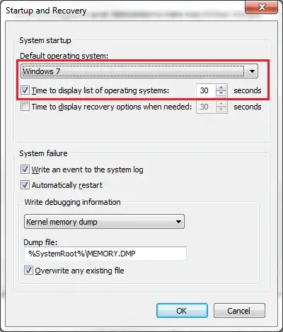

If you just want to stop the message at startup asking which OS you want to boot to, you can change the Startup & Recovery to have Windows 7 as the default and uncheck the "Time to display list of operating system" or set the display time to 0. That way you will never be asked which OS you want to boot to, the computer will just boot into Windows 7.
alt text
