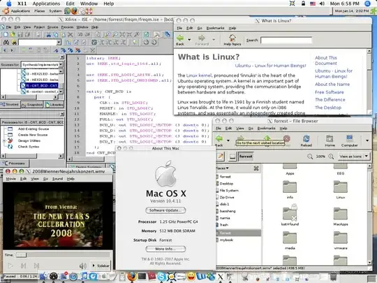

What types of applications do you need to access on the Ubuntu side? If you don't need the entire desktop, you could consider using SSH with X11 forwarding. That is, log into Ubuntu from OS X using ssh -X and then run GUI programs. This depends on you installing X11 on OS X, which is available on your Mac OS X Install DVD.
A guide is available at this link. It's for an older version of Ubuntu; I think X11 forwarding is enabled by default in the current version 10.04. Of course, you could load the entire desktop, such as the example in the image below.
