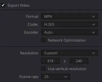

I loaded that in DaVinci, extracted the clip, then rendered as mp4, H.265, 318x240, 25 fps:

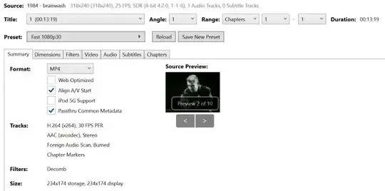

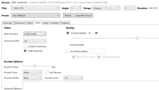

When I load the clip in HandBrake, it tells me the source is 318x240, 25 fps. Even though it's in H.265, HandBrake tells me it's in H.264. Then HandBrake also contradicts its source information by saying under "Tracks" that it is 30 fps and that the size is 234x174.
In Handbrake's "Video" tab, the encoder comes up as H.264 and the frame rate as 30. The RF is 22:
I changed that to 265 and 25:

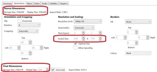

The "Dimensions" tab says again that the size is 318x240, but then says that:
The scaled size and the final storage size are 234x174. I tried clicking several things and cannot get it to change that output size.

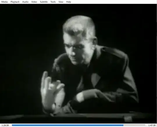

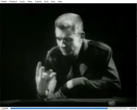

Original flv file: enter image description here

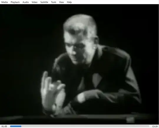

Mp4 converted by Ffmpeg: enter image description here

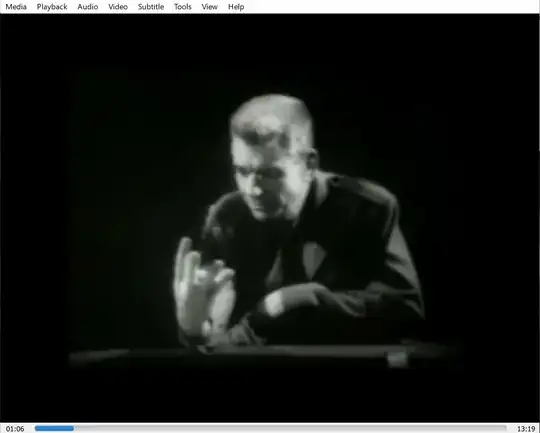

Clip rendered by DaVinci.
This might give a clue to the problem. The image occupies less than the full window of the player. Did DaVinci reduce the scale of the video?
Clip compressed by HandBrake: enter image description here

  • Indeed, it doesn't make much sense using Handbrake in this context, for your intended purpose. And what you're seeing is not the characteristics of the loaded video but the settings of the preset. – ChanganAuto Mar 21 '24 at 18:08

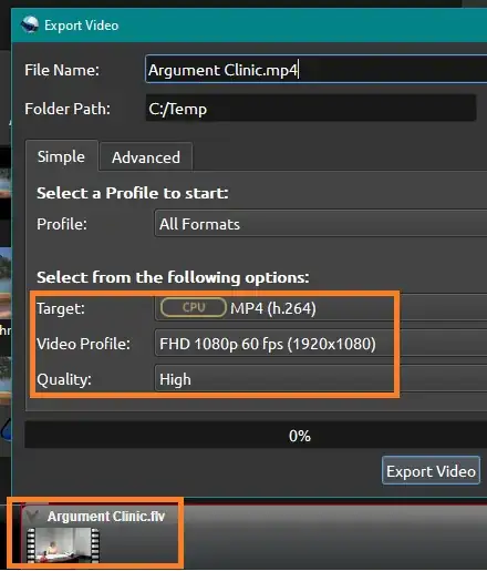

This is a work-around, rather than an exact answer: do the whole process in a single step using a GUI that gives complete control of how the output is saved.
Two free, open source, video editors, Shotcut and OpenShot (both available in Linux, and Mac, as well as Windows versions, and both Windows app run under wine, too, on this Ubuntu machine), for example, can open FLV video files, edit them, and save the edited output in various formats and with adjustable resolution and quality. There are many alternative video editors, too.
OpenShot Export Video Dialog
The screenshot above is from the OpenShot Export Video dialog, and ShotCut offers even more granular control of output. One selects the segments to edit, applies filters such as Sharpen, if desired, and exports with color gamut (e.g., Broadcast, MPEG or JPEG), resolution, frame rate, compression, etc. under user control, all with a single tool. Neither program is intimidating to use, since reasonable defaults are preset.
