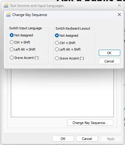

Language Switcher Keys
A common solution I see posted is that people have completely disabled their backtick key to allow them to switch languages. That is not my problem:
Language switcher keys are disabled

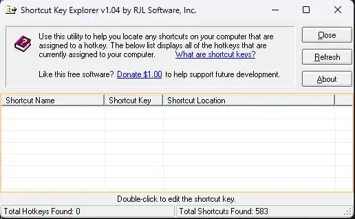

Shortcut (.lnk) keyboard shortcut
Someone else recommended using a tool to find shortcuts (.lnk files) with keyboard shortcuts set up on them. This tool has not found anything.
Shortcut Key Explorer comes up empty

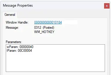

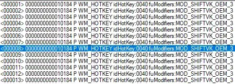

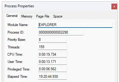

Spy++
I have tried using Spy++ to track down which window is intercepting the key as a hotkey. I found solutions like this one recommending this approach.
And this does indeed show that the key combo is being intercepted as a hotkey:
a list of WM_HOTKEY messages from Spy++

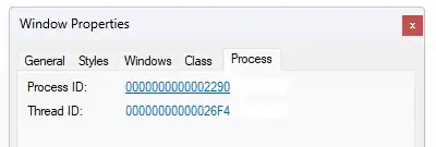

but if I follow the links through this tool to find the specific Window + Process, it just points to "Explorer". I don't know where to go from here:
WM_HOTKEY message properties
Window Properties
Process Properties

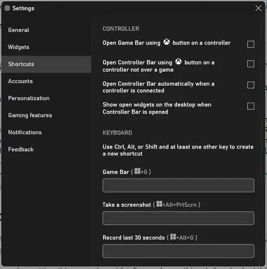

Xbox Game Bar was configured with the hotkey.
I saw someone recommend checking Xbox Game Bar for shortcuts. And sure enough, I found the shortcut for Shift+` was set up on the game bar
I don't remember setting this up, perhaps I fat-fingered something. I also checked this screen multiple times - but there is a SCROLL BAR very subtly hidden on the right side of the dialog. This screenshot shows how the window looked to me when I opened it just now and happened to finally notice the scroll bar:
ugh

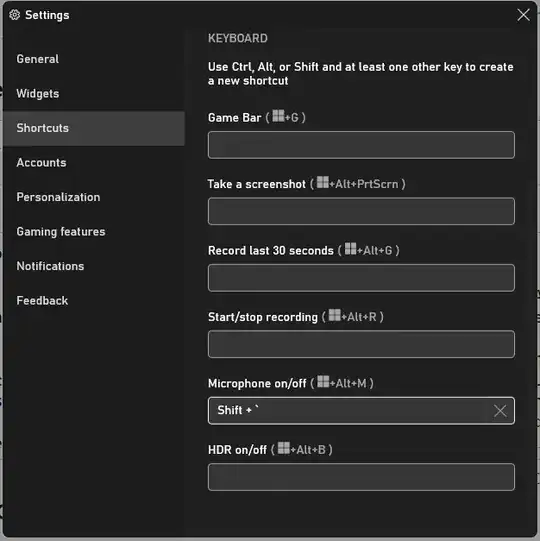

And if I scroll down...
there it is in all of its fine glory
I'm very annoyed but also very glad to have finally found this!
