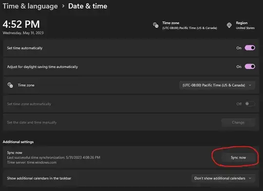

This is the NTP Sync button I am using:
Sync Now

  • @Ramhound I am not modifying the time zone setting. I've attached a picture of the NTP sync button which is causing the issue. – Duncan May 31 '23 at 23:57
