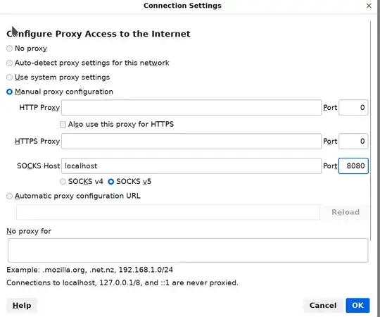

Instead of running a web browser remotely, it might be better to use SSH's dynamic port forwarding feature:
ssh -o HostKeyAlgorithms=+ssh-rsa -o PubkeyAcceptedKeyTypes=+ssh-rsa -D 8080 -p 2022 remoteuser@<remotehome>
and then configure your web browser on your laptop to use a SOCKS proxy on localhost, port 8080:
Firefox proxy settings dialog
(Remember the original proxy settings, you will need them later.)
Now, the Firefox on your laptop will connect the listening socket created by the SSH client, and all connections made through it will be forwarded to the sshd at the remote end of the SSH connection. Since sshd understands the SOCKS protocol, Firefox can now ask the remote sshd to make connections to any service.
And hey presto, you can browse as if your network connection was at the remote desktop, but your web browser runs fully locally, so window updates are quick and efficient!
