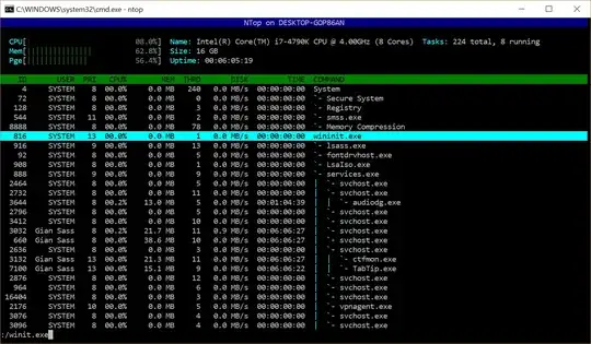

You can try NTop (binaries), an htop alternative for windows, with Vi-emulation for Windows:
Screenshot
  • Command line options:
    • C: Use monochrome color scheme
    • h: Display help
    • p <PID>: Show only the given PIDs
    • s <COLUMN>: Sort by this column
    • u <USERNAME>: Only display processes belonging to this user
    • v: Print version
  • Interactive commands:
    • , , PageUp, PageDn, j, k: Scroll the process list
    • CTRL+ or : Change the process sort column
    • g: Go to the top of the process list
    • G: Go to the bottom of the process list
    • Space: Tag a selected process
    • U: Untag all tagged processes
    • K: Kill all tagged processes
    • I: Invert the sort order
    • F: Follow process
      If the sort order causes the currently selected process to move in the list, make the selection bar follow it (moving the cursor manually automatically disables this feature).
    • n: Next in search
    • N: Previous in search
  • Vi commands:
    • :exec <command>: Executes the given Windows command
    • :kill <PIDs>: Kill all given processes
    • :q or :quit: Quit NTop
    • /<PATTERN> or :search <PATTERN>: Do a search
    • :sort <COLUMN>: Sort the process list after the given column
    • :tree: View process tree
