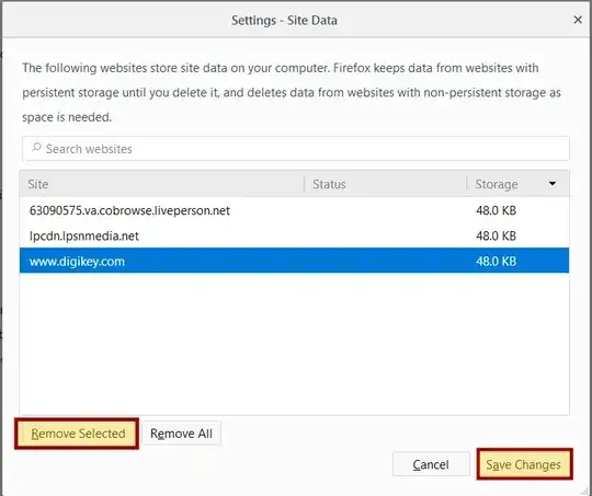

Looks like they might of changed a few things. I found the following:
- Menu -> Options
- Privacy & Security -> Site Data -> Settings
- Highlight the Selected Site and select Remove Selected
- Select Save Changes
- Finally click Remove
- 213
I could be wrong but it looks like this option only selects sites that have stored temporary data. For *those* sites, yes, it clears cookies and everything else. For a site that has *not* stored temporary data, it doesn't appear in the list so you can't just clear cookies. However! If you Clear All Data, it does get all sites somehow. Ugh - as I just did while entering this text. I think this specific feature needs some more testing. – TonyG Feb 19 '18 at 20:53
