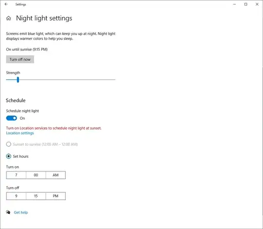

How to check if Night Light is enabled on Windows 10 using a batch file? I think it can be accessed from Windows Registry, but I'm unsure about how to do it.
I'm trying to get and set/change the value of the Blue Light Reduction setting.
I found this and many others, but I'm not sure how to only get the value and not change the settings (nor do I know which command is for getting and which is for setting or what file I should put it in).
It would be better if I could do this using BAT files and even better using Python.
If there's no API/library for doing this, I'd go for getting the key's value to check if Night Light is enabled and changing its value to enable/disable Night Light.
If Windows Registry is involved, please specify what language it is and what file the code should be in (.bat if it's Batch code and .py if Python, for example).

Using it
Save the script as a .ps1 file and follow the instructions in the Enabling Scripts section of the PowerShell tag wiki. You can then import the script's contents by dot-sourcing:
. ./bluelightmanagement.ps1
And then use the cmdlet-like function that it supplies:
Set-BlueLightReductionSettings -StartHour 7 -StartMinutes 0 -EndHour 21 -EndMinutes 15 -Enabled $true -NightColorTemperature 6000
the results
The Settings app even updates everything (except the strength/color slider) immediately if you have the blue light reduction page open when you run the command. For the slider to see the changes, you'll need to reopen the Settings app.

  • Oh, ok, and yes, I refreshed to check, but it's the same. It's fine; I was trying to make a small utility for myself to turn Night Light off every time my PC boots, as sometimes, it takes some time to (probably load the registry or some well-hidden logs and) turn it off. – The Amateur Coder Jun 07 '22 at 17:02
  • I don't usually meddle with Windows 10 settings because almost half the settings are accessible via the Control Panel too, and some only through it; clicking "Schedule night light" under "Night light settings" KEEPS IT ON (probably, by default, Night Light is scheduled to be turned on from a set time to another), but not scheduling Night Light: Night Light is on ALL THE TIME. – The Amateur Coder Jun 07 '22 at 17:14
