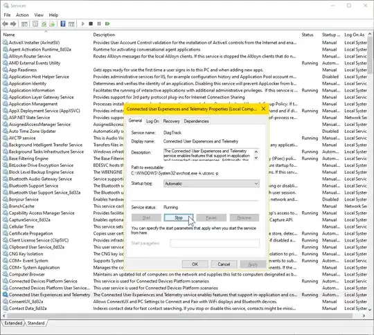

1. Disable the DiagTrack service in Windows Services
Hit WinKey+r, type (or paste) services.msc and press Enter. Sort by name and look for Connected User Experiences and Telemetry. Double-click that service.
At Service status: Running, click Stop. At Startup type: Automatic, change to Disabled.
Click OK and F5.
Stop and disable the DiagTrack service.
^ click to enlarge
Make a software restart of the computer – press WinKey+x followed by u and r.
– With this single change it now takes less than 8 minutes for Windows to start up – including the time it takes to log in.
You may have to do this every time Windows Update installs a new build version.
