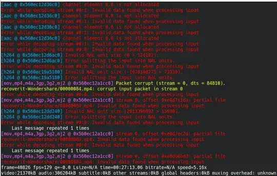

Analyzing with FFMPEG
I tried to analyze the video file by this command:
 > ffmpeg -i recoverit-Wondershare/00000084.mp4 -f null -
The analysis is fine up to 27m time. Then these errors are thrown:
[aac @ 0x560ec12d36c0] channel element 0.0 is not allocated
Error while decoding stream #0:1: Invalid data found when processing input
Error while decoding stream #0:0: Invalid data found when processing input
[h264 @ 0x560ec12d6ac0] Invalid NAL unit size (0 > 124102).
[h264 @ 0x560ec12d6ac0] Error splitting the input into NAL units.
[h264 @ 0x560ec19a5180] Invalid NAL unit size (-1676108775 > 73339).
[h264 @ 0x560ec19a5180] Error splitting the input into NAL units.
[mov,mp4,m4a,3gp,3g2,mj2 @ 0x560ec12a1cc0] Packet corrupt (stream = 0, dts = 84810).
recoverit-Wondershare/00000084.mp4: corrupt input packet in stream 0
[mov,mp4,m4a,3gp,3g2,mj2 @ 0x560ec12a1cc0] stream 0, offset 0xe8d711da: partial file
recoverit-Wondershare/00000084.mp4: Invalid data found when processing input
[h264 @ 0x560ec12dd240] Invalid NAL unit size (2013396992 > 15690).
[h264 @ 0x560ec12dd240] Error splitting the input into NAL units.
    Last message repeated 1 times
[mov,mp4,m4a,3gp,3g2,mj2 @ 0x560ec12a1cc0] stream 0, offset 0xe8d7ec2d: partial file
[mov,mp4,m4a,3gp,3g2,mj2 @ 0x560ec12a1cc0] stream 0, offset 0xe8db8bd3: partial file
frame=40826 fps=129 q=-0.0 Lsize=N/A time=00:27:13.06 bitrate=N/A speed=5.16x
video:21370kB audio:306204kB subtitle:0kB other streams:0kB global headers:0kB muxing overhead: unknown
FFMPEG Analysis log

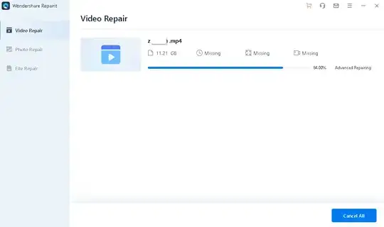

I had already used Wondershare Recoverit to recover the lost videos. So, I tried Wondershare Repairit to repair the videos!
Wondershare Repairit processed the 3 GB videos. Its output preview is a 28min video. I can only preview it in low quality. To actually save it, I had to purchase the license.
Also, Wondershare Repairit processed the 11 GB video. Normal process was not enough. So, advanced process was done by providing a sample video. I used the 3 GB videos as sample video of 11 GB video! Well it worked. The process was complete and the output preview is a 43min video. Well, here is the disappointing thing: the 43min video is just a subset of 28min video which is repeated twice!
So, eventually, I have around 27 or 28 min of watchable video in my hands. I don't know what are my odds to go further. I'm going to checkout other approaches suggested by @Silbee .
