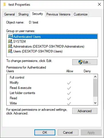

And here is the security tab of the test folder's properties:
security tab of test folder's properties
  • By "I tried all the commands as Administrator", do you mean that you ran CMD and PowerShell using "Run as Administrator"? If no - please try it. If yes - please add screenshots of the Properties of the two folders Security tab. – harrymc Oct 05 '21 at 10:25
  • @harrymc yes, I ran cmd and powershell using "run as administrator". I added screenshots of the folder properties' security tab. – Cave Johnson Oct 05 '21 at 17:33
  • Do Administrators have Full control on both folders? – harrymc Oct 05 '21 at 18:15
  • @harrymc yes... – Cave Johnson Oct 05 '21 at 18:30
  • This then doesn't look like a permissions problem. Is it possible that one of the folders is sometimes used/locked by some program? Try doing it while booting in Safe mode. – harrymc Oct 05 '21 at 19:33
  • @harrymc doubtful as I just created both folders with mkdir before creating the symlink but I can try the safe mode thing later. – Cave Johnson Oct 05 '21 at 20:01
