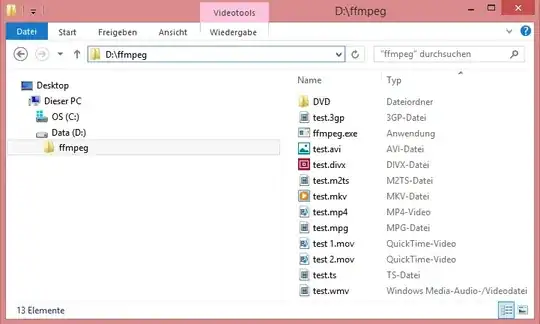

Video files:

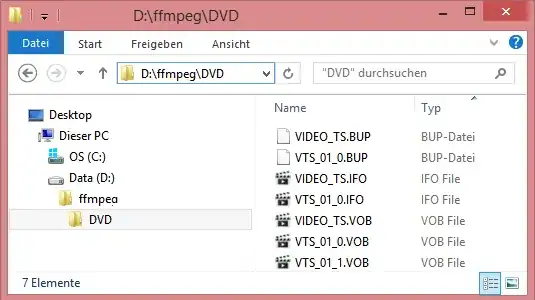

DVD directories contain:
Files in DVD directories were recorded with a DVD recorder and then copied from the DVD to my computer hard disk.
Let say the above directory D:\ffmpeg is my work directory for ffmpeg. Which means all video files are stored there.
My wish is to convert each file to mp4 and mkv (for test purpose). For example the input file test.avi should give two output files test.mp4 and test.mkv. The output files should have the same properties as the input files. Important for me are screen size, aspect ratio and frame rate. Video and audio quality should stay nearly the same, so that the difference is imperceptible. The audio codec should only fullfill the audio quality an can be for example aac, mp3, flac or vorbis. I don't know if ffmpeg can take the audio/video quality (kb per s) settings from the source files for the output files. The video codec should be h.265, if even possible. The menus of DVD (if present) files should be dropped and the DVD source files should be merged to one output file.
