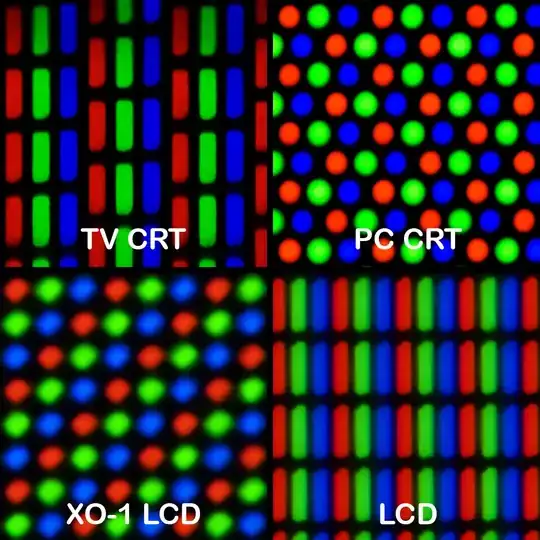

Another interesting point I've found is this picture:
Photo of various monitors with individual light-emitting elements visible Pengo, CC BY-SA 3.0, via Wikimedia Commons
Apparently, TV CRT pixel grid seems to have its columns offset considerably, but is this a result of how beam is controlled (so fluorescent lines are actually uninterrupted)? Would it have a regular pixel grid if hooked to computer's video output?

    Unsure about the overall question, but the TV CRT pixel grid is laid out like that to compensate for relative low resolution so pixels actually blur a bit to improve video quality. For PC use? It will blur a bit so things like small fonts would be difficult to read at best. This is why back in the day when CRT TVs were still common, many people who did digital editing would have a CRT of some kind hooked up to their setup so they could immediately see how what they set on their PC looks on an actual TV CRT tube… Or at least the lowest common denominator TV CRT tube. – Giacomo1968 Jul 21 '21 at 23:13

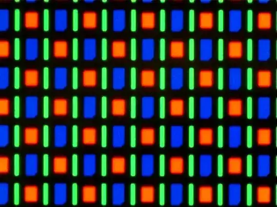

Though AFAIK, displays have regular patterns, there are some less common patterns, such as PenTile RGBG.
By Matthew Rollings at English Wikipedia, CC BY 3.0, https://commons.wikimedia.org/w/index.php?curid=14914205
You might also find the pattern of pixel colors in sensors of interest, but again, they are not irregular, just in a different pattern.
