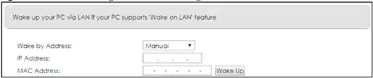

According to the User’s Guide VMG8825-B Series manual page 132, you should be able to assign a static address to your computer in Network Setting > Home Networking > Static DHCP. The address should be your internal IP, for example 192.168.1.10.
Once this is done, sending a WoL package to the router's public IP should wake your computer. This should be done from outside your local network.
If this doesn't work, some element of hardware or software does not support WoL. See this post for a list of requirements: RDP wake-on-lan in LAN environment.
In the case that you have access to your router's configuration page from outside of the network, you can force the sending of a WoL package to your computer from this page.
In the manual, see on page 137 the section of "The Wake on LAN Screen".
Click Network Setting > Home Networking > Wake on Lan to open this screen:
Enter the computer's internal IP address or its MAC address and press the "Wake Up" button.

    You access the router's configuration page through its public IP address, or its DDNS name if configured (manual page 61). Setting the router login is covered in "Remote Management" on page 283. When enabling this, set the router login to non-default values that are long enough to be proof against brute-force attacks, as you will certainly be attacked (as we all are). – harrymc May 17 '21 at 16:16
  • Ah, thanks! I wanted to mark both answers as valid because both are relevant. Anyway I did try to access my router through the public IP address (actually the hostname I setup via the DDNS service), but nothing loads. I suppose I should enable something in the settings at this point. – wtfzambo May 17 '21 at 16:25
  • So, I eventually managed to connect to my router's web gui thanks to my flatmate (she turned on the pc for me). It turns out that I already did setup a static DHCP for home pc, due to the fact that I cannot use directed broadcasting. As before, im able to wake the pc up if it's been turned off for a few minutes, but I cannot after some time has passed. – wtfzambo May 17 '21 at 20:51
