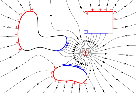

EDIT: Electrostatic induction (or: replying to magic and sparks)
from Wikipedia Image is Public Domain. Electrostatic Induction
Surface charges induced in metal objects by a nearby charge. The electrostatic field (lines with arrows) of a nearby positive charge (+) causes the mobile charges in metal objects to separate. Negative charges (blue) are attracted and move to the surface of the object facing the external charge. Positive charges (red) are repelled and move to the surface facing away. These induced surface charges create an opposing electric field that exactly cancels the field of the external charge throughout the interior of the metal. Therefore electrostatic induction ensures that the electric field everywhere inside a conductive object is zero.
As is easily imaginable, if the charge (= Cat) moves, the charges in the metal surface (=PC case) will move, too, creating a current. If the PC case is not properly earthed, sensitive parts could feel this current.
There won't be any flying sparks since we speak about induction.
