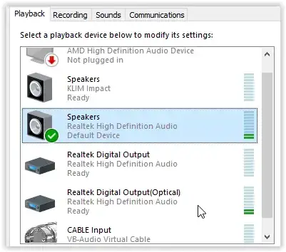

When I use my speakers as DEFAULT OUTPUT DEVICE I can redirect the audio to my "Realtek Digital Output" device. As you can see, both devices show an active output signal.
Both devices active
Stereo Mix shows the same signal and is setup as follows:
Mix setup Stereo mix

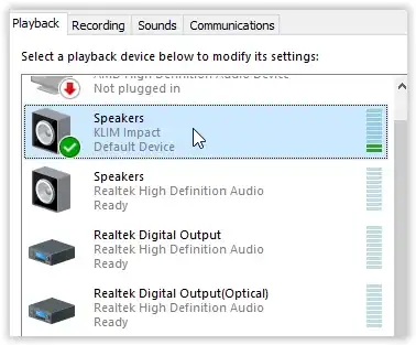

However, if I make my headset the DEFAULT OUTPUT DEVICE NEITHER the digital output NOR the Mixer continue to display the output signal and the signal NO LONGER is forwarded to "Realtek Digital Output".
Why is that, what could be the reason?
No mixing signal

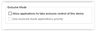

Some have written I need to disable "Exclusive access", but it did NOT help.
Exclusive access

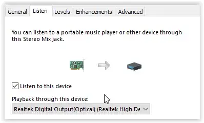

    One thing I noticed was that the "Stereo Mix" recording device is a Realtek device. Try setting the Realtek output you want to use (either analog speakers or optical) as the default device, then with Stereo Mix > Properties > check "Listen to this device" and set "Playback through this device" to your KLIM headset. I'm curious to know if this configuration will work for you. My hunch is that the Realtek playback device can forward its audio to other playback devices via its driver, but the other non-Realtek devices cannot forward their audio because they use a generic driver. – Blaelph Jan 28 '21 at 01:48
  • Thanks for the hint: This indeed works (have tried that a while back), and I have further noticed that in ALL the YT videos about this topic it seems to be a REALTEK mixer as well. Strange that there is no mixer by Logitech or others. Looks a bit as the mixer is a REALTEK only thing while it sounds somewhat like a generic Windows feature. – Horst Walter Jan 28 '21 at 11:03

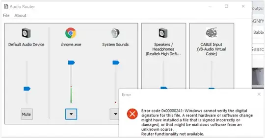

One of the best summaries about this topic is this Quora answer by James Gurr: I have tested Audio Router and it would be exactly what I need, unfortunately it is no longer maintained and has an issue with SOME applications (because of driver signatures, I could switch those off, but ...) such as Chrome. However, some other applications as Firefox work just fine. Some keep hanging.
driver signature hanging
