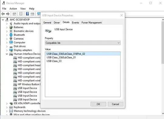

Do each usb device send some unique information about them to the computer to be recognized by the computer?
Yes.

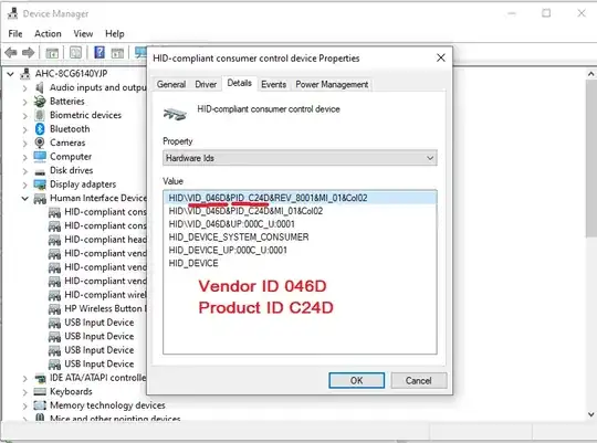

Basically USB devices have a class number (which isn't super unique across devices but does define the "type" of device), and a Vendor ID (VID) and Product ID (PID) that they tell the host when they connect. On Windows, in Device Manager, you can see the USB class number here under "Compatible IDs" ...
... and you can see the VID and PID under "Hardware IDs" ...
Device manufactuers get new USB VIDs from the USB Implementers' Forum, and the USB-IF also maintains the list of class codes.
The example above, if you look at this, you can see that Class 0x03 is a "Human Interface Device." An OS or other can support things based on class, or combination of class+PID/VID.
USB vendor IDs (VID) and product IDs (PID) are 16-bit numbers used to identify USB devices to a computer or other host. Each vendor ID is assigned by the USB Implementers Forum to a specific company, which in turn assign a PID to individual products. Reference

2Another nearly wrong answer. The most significant information a device provides is its CLASS. The class defines which generic driver to load. VID and PID are used only if the device has any individual proprietary features, then they need to be enabled by device-specific driver. HID is one of USB generic classes. – Ale..chenski Sep 22 '20 at 16:48
2I added info about classes. The VID and PID are useful if you're trying to hunt down the driver for some weird USB device. – LawrenceC Sep 22 '20 at 17:24
