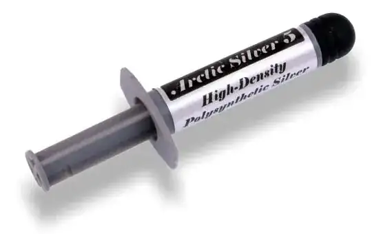

I do this to all my notebooks - open up the notebook, separate the heatsink assembly, clean up all the old thermal compound junk with an alcohol swab. Then go get some Artic Silver 5 (one of the best thermal compounds out there) pictured below, and apply. Reassemble the heatsink assembly and your notebook.
alt text
On average, you can see a 3 degrees celcius drop in your operating temperature. If you are even more gung-ho, swap out the notebook fan with a silent, more powerful after-market alternative.
Also, at times when my notebook is still warm, I actually drill small holes into the casing after studying the airflow. I have only done this on ONE occasion though, and it's because it was simply running too hot - managed to drop it by another 2 celsius.
P.S Please be sure you know what you are doing before trying this - not responsible for a bricked notebook.
