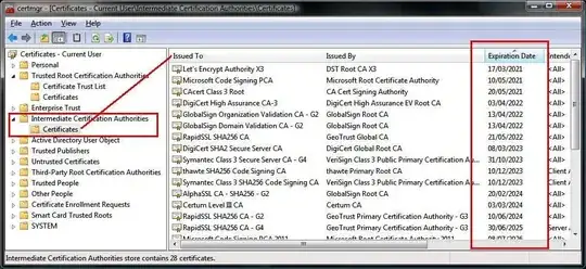

Navigate to your Windows CA certstore, by loading the certmgr.msc (certificates manager) snap-in:
Cert Mgmt UI
Expand Intermediate CAs -> Certificates, then sort stored intermediate certificates by Expiration Date; then proceed to delete ALL the expired ones (you may want to export them to a PFX first).
Try updating YouTube-DL again.
Source/more info: youtube-dl -U == ERROR: can't find the current version. Please try again later.
