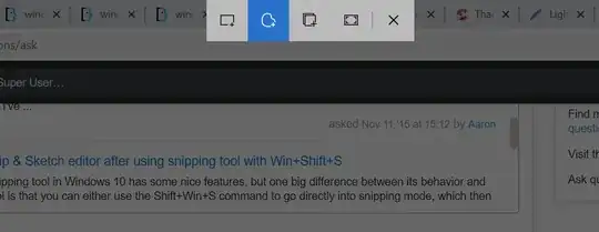

The Windows' screenshot application looks like this: enter image description here

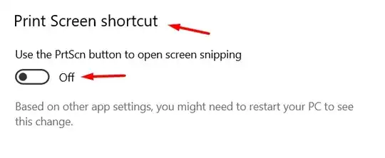

Before setting up or installing lightshot, turn off Print Screen Shortcut under Ease of Access Keyboard Settings, then install lightshot, it should register "prtscr" as default. Its working 101% fine at my end.
To turn off Print Screen Shortcut;
Step 1: Search for Ease of Access Keyboard Settings
Step 2: Find Print Screen Shortcut
Step 3: Turn off the toggle

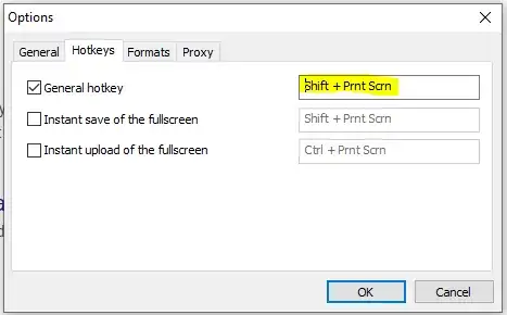

Changing Ease of Access Settings (as recommended in the other answers) did not work for me, but changing the HotKey to Shift Print Sc is one workaround. Open Lightshot options:
Change the Hotkey to Shift Print Sc:
emallove
  • 474

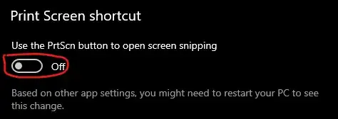

To restore the classic behavior of the PrtScn key (which allows other applications to use it as a hotkey)1, you can go to:
Settings > Ease of Access > Keyboard
..and then on the right, under Print Screen Layout, uncheck the checkbox that says:
Use the PrtScn button to open screen snipping.
Print Screen Shortcut Settings
1 Tested with the latest version of Lightshot and the hotkey works just fine after disabling that option.
  • Unfortunately, this box is already unchecked, and has been unchecked the whole time. Thanks for trying though, I really appreciate it! – Tori V. Jul 17 '20 at 17:17
  • @ToriV. That's strange! Can you please specify in your question what version of Windows 10 you're using? I tested this with Lightshot and it works just fine. – 41686d6564 Jul 17 '20 at 17:20
  • I know it's crazy! It's a Lenovo IdeaPad Flex. It's Windows 10 Version 1909. I don't know if that helps or gives you any extra information. – Tori V. Jul 17 '20 at 17:27
  • @ToriV. I'm not sure what went wrong. I'm using Win10 1909 as well. The hotkey works when I disable that option and stops working when I enable it as demonstrated in this gif. If it's feasible, you might want to reset your PC and try again to save yourself a lot of trial and error. – 41686d6564 Jul 18 '20 at 03:56
  • I'll maybe try that. Thanks for the help and all the suggestions, even the ones that didn't work. I'm grateful that you tried! – Tori V. Jul 19 '20 at 02:55
