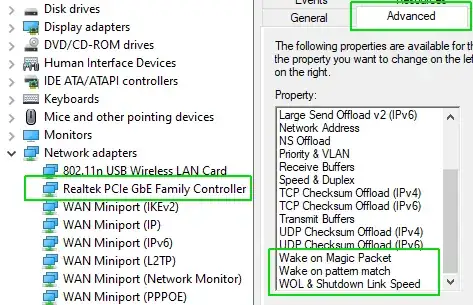

Right click Start - click Device Manager - expand Human Interface Devices, Keyboards, Mice and other pointing devices, Network Adapters, and Universal Serial Bus Controller.
  1. Uncheck allow this device to wake the computer. screenshot of device manager
  2. Network Adapters: only allow a magic packet to wake the computer OR
  3. All wake on "Magic Packet" or "Pattern Match" or "Link Settings" of all network adapters are set to "Disabled" in the Advanced settings of the devices in Device Manager.
Screenshot network adapters

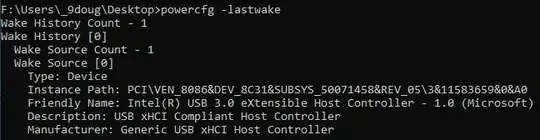

I put my PC to sleep, woke it up with the USB keyboard, ran powercfg -lastwake:
Wake History Count - 1
Wake History [0]
Wake Source Count - 1
Wake Source [0]
Type: Device
Instance Path: PCI\VEN_8086&DEV_8C31&SUBSYS_50071458&REV_05\3&11583659&0&A0
Friendly Name: Intel(R) USB 3.0 eXtensible Host Controller - 1.0 (Microsoft)
Description: USB xHCI Compliant Host Controller
Manufacturer: Generic USB xHCI Host Controller

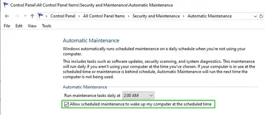

Automatic Maintenance: Left click Start. Type Control Panel. Click Control Panel App - Security and Maintenance - Maintenance - Change maintenance settings
screenshot of Automatic Maintenance
