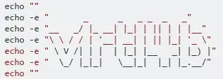

I am more new to shell programming and I am encountering such an error. Why does it give such an error? can you please tell me?
    #!/bin/bash

This fragment:
echo -e "\ \ / / | '__| __| | || |_| '_ \"
echo -e " \ V /| | |  | |_| |__   _| |_) |"
These are not two separate commands. If you try to run just the first line, you will see the shell expects further input.
Double-quoted \" at the very end of of the first line is an escaped double-quote. It does not close the quoting. The following newline character is double-quoted, so the command continues. The quoting ends at the unescaped " after echo -e in the next line. The characters that follow are unquoted; this includes | | |. Unquoted | is a pipe operator. Two or more pipe operators in a row are invalid, hence the error.
Since double-quoted backslash (\) can be special, it's safer to use single-quoted strings. Unless a string contains the single-quote character itself ('). Some of the strings in your code do, including the troublesome one. You can still achieve the desired result by quoting different parts differently, or by proper escaping.

Meta note
Our site gave you a hint by coloring your code in the question itself, as soon as you posted it. The coloring scheme seems to change. This is the screenshot (in case something breaks in the future):
screenshot
