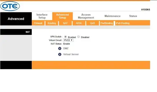

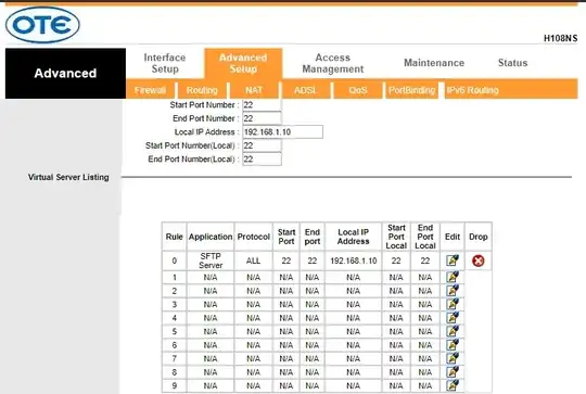

So I accessed my modem/router (an ZTE H108NS) and went to Advanced Setup -> NAT -> Virtual Server and added a port forwarded service for the SFTP Server as shown in the screenshot:
screenshot
I use my public IP and port 22 to my SFTP client to connect to my server but I can't. Connection is timed out.

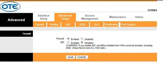

The router's firewall is enabled, but as I know it doesn't matter when I use port forwarding. Am I right? Does SSH protocol also needs port tunneling?
Here is some of my router settings that may be useful to you:
screenshot1 screenshot2 screenshot3
