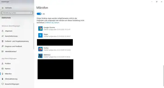

Here is a screenshot showing that Firefox has access to the microphone (sorry that I have this in German only...) Microphone settings showing that FF and Chrome have access to the microphone

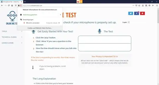

  • Screenshots of Firefox and Chrome interfaces showing the device is detectable would be appreciated. – Ramhound Jan 25 '20 at 19:49
  • @Ramhound I have edited the question. FF is in German. I hope you can interpret it correctly anyways. Otherwise let me know your question and I'll provide you with a translation. – Samufi Jan 25 '20 at 19:58
  • I absolutely cannot read german. I was looking for the internal interface within Firefox instead of a website anyways. – Ramhound Jan 25 '20 at 20:00

  • @Ramhound What do you mean with "internal interface within firefox"? The symbol at the top and the text in the speech bubble ("Mikrofon verwenden -- temporär erlaubt" --> "Use microphone -- allowed temporarily") should already give you a first hint. – Samufi Jan 25 '20 at 20:04
  • @NatsuKage Yes, FF and Chrome appear in the list. I'll provide another screen shot. – Samufi Jan 25 '20 at 20:08
